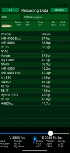

I've started working loads for my newest 260 build, a Savage mdl 10 LH action with a Shilen Select Match SS barrel. THis is a deer rifle that may see some coyote hunting from time to time. Since the heaviest bullet I am planning on shooting is a 130 gr and a 120gr being what I'll shoot most of the time I selected a 1-9 twist.
I have Sierra's 5th edition reloading manual that I bought about four years ago, Sierra's 6th edition reloading app and use Hodgdon's online data. There is a big difference in the data from min to max charge weight to the same weight charges velocity data. I understand different barrel lengths affect velocity but you'd think there would be a "standard" for testing. Even the Sierra 5th and 6th editions are different.
From Sierra's 6th edition app

I expected Hodgdon's data to be different but Sierra's data changed quiet a bit. For example I'm loading IMR 4064 in this 260, the book lists 33.6gr for 2600fps, the app lists 36.2gr for 2600fps, the book lists 35.7gr for 2700fps and 37.8 for 2800fps. The app lists 37.5 for 2700fps and 38.9gr for 2800fps. The book max is 42.0gr at 3000fps, the app max is 39.4gr at 2810fps.
I can see their lawyers changing the max load, but what changed the min-max so much? I also noticed that Sierra doesn't list pressures.
I called Sierra when I noticed the change between the 5th and 6th edition. It was explained to me the reason it changed was the testing method. In the older manual they used a standard receiver and swap out barrels, but a regular rifle. The new one they used a rig that measures pressure and set up the mural using pressure data.

They simply tested again between publications. There are a few things to note.
Different
seating depth
Powder lot
Bullet lot
If it’s true they changed methods, then also a different barrel and chamber.
All those changes will certainly change data.

Don't forget to use the same COL as published.
This was the biggest change Sierra made between publications. People are used to adjusting for component lots, the seated depth of the bullet generally remains constant.
Seating the bullet .045" deeper with the new data is enough to work up a new load, even with the same components.
