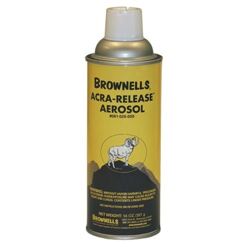

Brownells Acra Release is the best I've used. I don't do so much epoxy bedding that cost is much of a factor. Carnauba Paste Wax is a good thing as well if you can find it.
