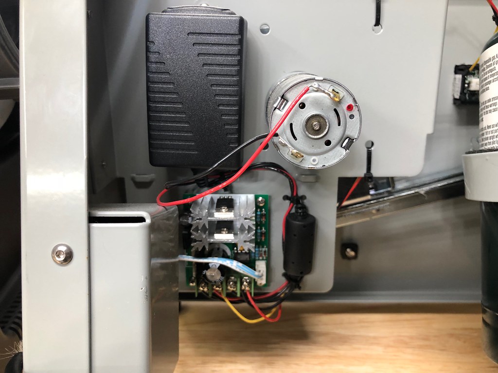

I have done the regulator mod, and managed to get the volt meter fitted into the machine. The wiring explanation in the Annealeze video is just different enough from the Giraud wiring, that my extremely limited electrical knowledge won't quite let me finish. If anyone could help out with a pic of the wiring of their completed GIraud connections, I would appreciate it.
Wiring on mine...
