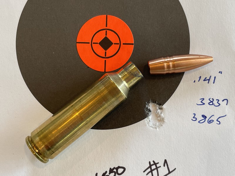

For my current load, neck tension is .004", and bullet jump is .027". Fill is at about 98%-99% in a Nosler case. I have found a potential accuracy node that I would like to further explore. Problem is, it is right at the charge weight where the gun pressured out. If I reduce the charge by 0.3gn, I no longer get pressure signs, but then I fall out of the potential accuracy node.
This rifle is for hunting, so I like the velocity, and would like to confirm whether this really is an accuracy node, and hunt with the load, if possible. Any suggestions on how I could eliminate these pressure signs without losing velocity, so I could safely shoot some more rounds at this charge weight to see if it really is an accuracy node? Change bullet jump? Change neck tension? Add a crimp? Change brass? Something else?

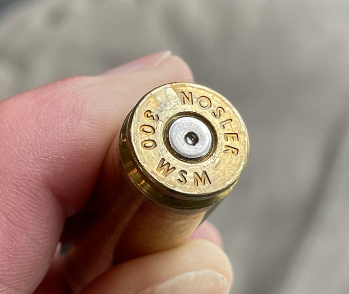

Primer corner is still round, but there is a slight, although unmistakable, ejector mark. Also, I get a stiff bolt lift at this charge weight.
The safe thing to do is back off of the powder charge a bit. If you change then seating depth you may see the velocity change a little because of the powder column space but you still may see the ejector mark as well. But then re-tune for seating depth.
First firing on brass? New brass is usually short. It gets slammed against the bolt face and can show ejector swipe because of that. The primer doesn't show high pressure. If bolt lift and velocity numbers concur, I'd set the shoulder back .002-.003 on the fired brass and shoot it again. Orient the cases so they are not aligned with existing swipe marks and see if it does it with the fired brass.
Good thoughts, gunsandgunsmithing. I should have noted that this is the 3rd firing for this brass. The shoulder was bumped back .003", and it was then annealed for this loading.

The node in the photo is at about 3850fps. The next accuracy node is at about 3775fps. So, the "easy button" would be to load to 3775 and be happy. I was just wondering if there was some simple "tweak" in the various loading parameters that could get me to 3850.

In hunting weather, ejector marks will probably go away. You are probably going to loose primer pockets at that pressure anyway. Sight the rifle in, hunt, verify zero as necessary, call it done.
