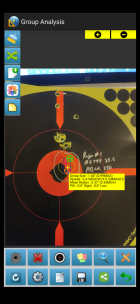

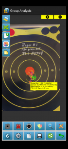

Working up some reduced recoil loads for deer hunting for my Rem 700 Mountain Rifle and Ruger No. 1. My initial testing has my loads running about 2600fps for 130 grain using A5744. I also have a couple pounds of H4895 for the same purpose.
Out of the bullets below, which would you recommend (my current stock)? Shots no longer than 250 yards. I am leaning toward the Noslers. One of the nice folks on here suggested those as well.
