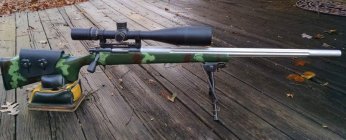

Remington 700SA BDL formerly haven been a .243 Win., 6mmBRX, and now .308Win.This rifle is now wearing a Muller Works 26", AMU contour, 1:10, 4R Modified Rifling barrel fluted with six 3/8" x .180" flutes. The stock is a modified 1970's era M-40. The barrel channel has been opened up and all Styrofoam removed and replaces with fiberglass resin and polyester filler and topped with fiberglass cloth for structural strength. The balance was adjusted by removing the Styrofoam was removed from the but stock and replaced with 20 0z. of fiberglass. The adjustable cheek piece and Badger bolt handle was installed.
This rifle is shooting in the teens and low .2s with Barnes 150 grain Tipped Triple Shocks, running 3025 fps. This is accomplished with a stout load of W-748.

Nat nice looking rifle. You do some fine work for sure. I'd sure hate to shoot that with that cheek piece being left handed. Might hurt just a little
