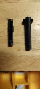

Just fixed mine last year. Get a small clear plastic tube that just slides down int the hollow center that the primers fall threw. Mine has no priming tube set up i hand prime mine. It's thin wall clear plastic tube abut 2' long. seals f the opening so no more primers fall out. easy t0 remove if you need t. Works 100% now for me.

I just pulled the plastic tube 0ut and measured it 0D is 7/16" and it slides in with easy and back 0ut. I cut it about 1 5/8" long works perfect. Slide it down till its a Wisker below the still ram and take it 0ut and time need......

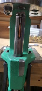

I had some 1/2" OD tubing so I cut a piece to the correct length then sliced a section out so it fit snuggly into the center of the ram. Works perfectly!!!!!

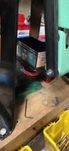

I spent the big bucks on a spent primer catch, cost around $40. Luckily I was able to use the powder to load ammo. Haha. I just cut a Tac powder bottle down and used the top half. A piece of doubled tape keeps it from moving so when it fills up with 4-5000 primers I can remove it and dump it. My ram kicks a primer out the front occasionally so I may have to do a filler just to stop that but its really pretty rare. I don't prime with my primer attachment
