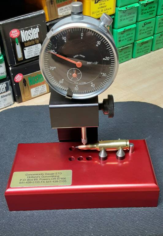

I've got beaucoup tools from Sinclair, but I've been using the Holland gage now for about 20 years with no complaints. It's not as sophisticated as the Neco or A1, but it does the deed and didn't break the bank either.
We've got some great sources for this stuff though, and LOTS of choices....= good.
