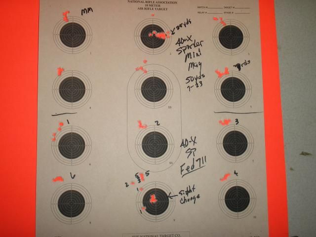

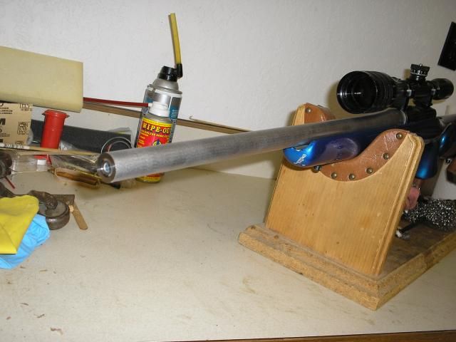

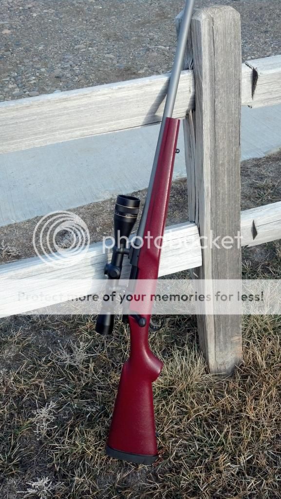

Bought a 40-XB stripped barreled action off GB advertised with "surface rust" on barrel. Figured the receiver was worth the $240 I pd shipped.lol Bore looked great though.Thought as they are straight taper I could take .010 to .020 surface cut full length and have it coated. Well when set up between centers the 28" barrel had about .020 curve/bow in O.D. So I wacked off 6" and recut it to a 'heavy sporter'. Muzzle diameter roughly .750" from original .90ish". Top target shot prior to tearing it down with mini mags, Green Tag and Federall 711, nothing expensive. Bottom target shot afterwards with Mini-mags and Wolf and I think I shot some 711 on another target also??? Some of the targets have 2 separate groups using different ammo etc, I was lazy and it wasn't from shooting to 2 different POI. Memory no good no more. Anyhoo with a T-10 and both stocks I used were previously bedded but not for this barreled receiver, just something it fit in. It shot as good or better after my inexperienced machinist skills butchered it up!!! :) NOT a guarantee or anything, just proof that all the hype about recontouring anything other than cut blanks might not hold much water. Only target ammo or worse and not match, only 10X, factory trigger, not perfect bedding and I have a 3 leade pacer/defib that induces horizontal of 1/2" or so @ 100yds generally. In other words it done pretty good considering everything IMO!!!!
Would agree with Stansrifles, a lot has to do with setup and how you go about it. All my recontouring has been done on my Atlas 36" as I don't have a taper on either of them and it is easiest to move tailstock and reset. Cheezy lathe but light cuts and stop to allow cooling after 3 passes or so. I setup steady and only do about 8" at a time and spend some time with files and emery to get nice finish. Not a money making way but I got way more time than money or machinery.
