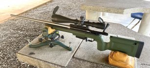

Well this is what we ended up with. Bighorn Origin action, 223 Rem Shilen 26” 1:8 twist rate with a varmint contour, KRG Bravo stock And TriggerTech trigger. The rifle is very easy to shoot and load for. I have worked up loads for Sierra 77’s, 69 MatchKings and 60 TMK.

Beautiful rifle and some great shooting. Looks like it'll get the job done.
