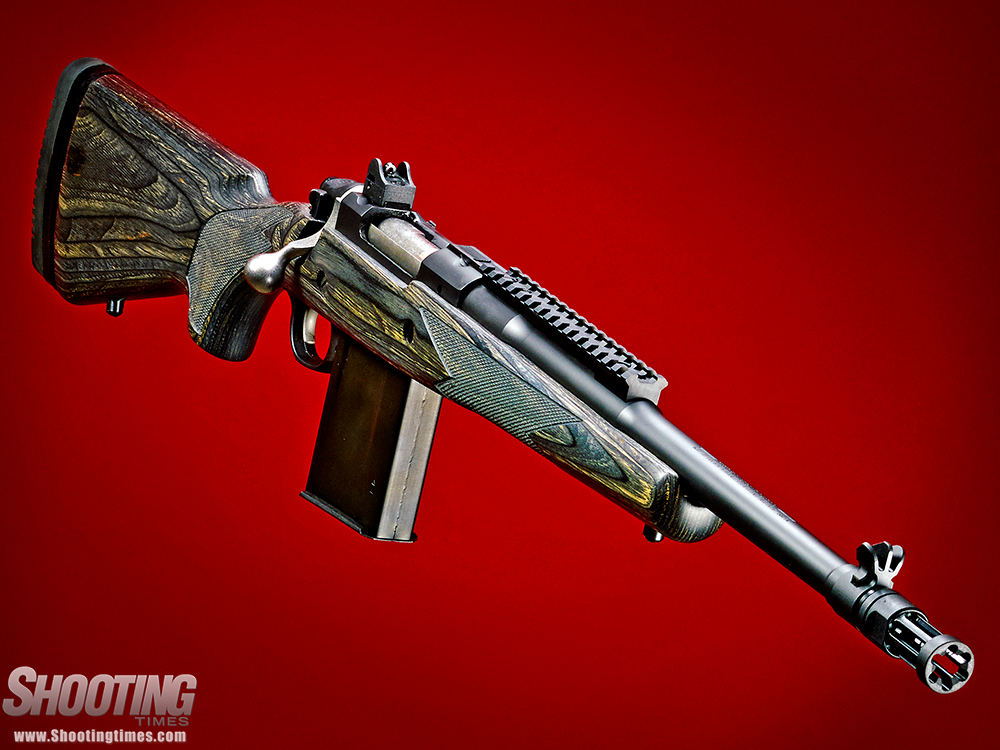

Looking for a bolt action .223 that I can use standing sitting and prone. Plan is to be able to use it appleseeds once in a while so 8rd+ magazines would be a huge plus, under 9lbs and capable of sub moa groups at 400m+ would be ideal. (Mag fed hand loads).
Ruger Scout looks like exactly what I am looking for, but I can't find any reviews on accuracy, what kind of loads it likes etc.
