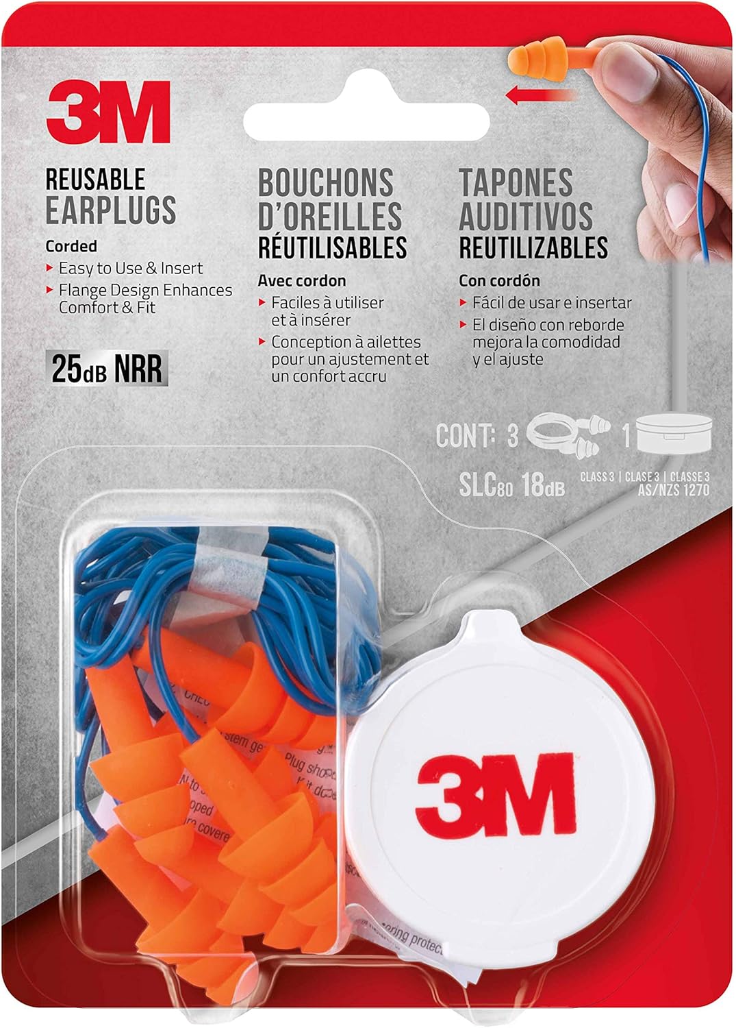

I ALWAYS hunt with ear protection! I have missed only a few shots while fooling around with the muffs.
Faster than muffs. Wear around your neck. Very easy/quick to insert and remove:
