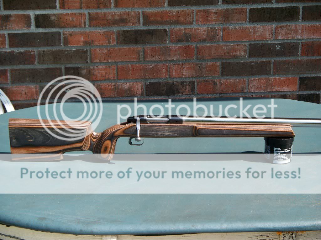

the little M-7 can be built into a very nice very accurate rifle just as the 700 can, here is a pic of one I just finished, but its only chambered in 6x47 lapua
JD

By the way, love your stock! and I also want to thank you for the tip regarding Joel. What a great guy to deal with, he`s about to make me a BR stock in maple. Will be awesome!
