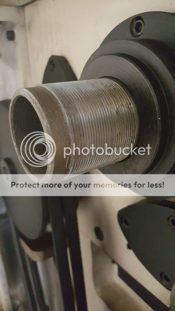

I'm making a rear headstock spider for my Jet. My spindle has M50x1.5mm threads on the rear end and has plenty of them exposed to thread the spider onto. Do Grizzley, Enco, and other import lathes use the same thread here?
Here is what my spindle looks like:

I'm confused. Do you mean you're making a spider on the outboard side of the headstock?
spindle has threads beyond the locknut but not past the door that covers the change gears. I'll post photos later.

I've added photos now and there isn't much unthreaded length. Metric threads aren't too bad if you use a higher speed. I used about 150 rpm makes them go quicker. --Jerry
