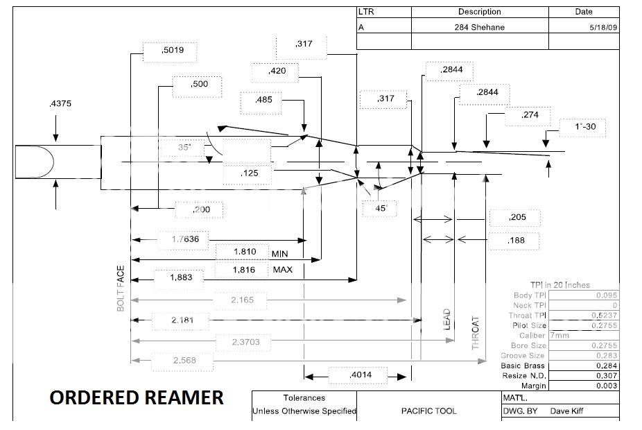

I just bought a 284 Shehane reamer from PTG. See below. This is going to be a sort of no neck turn setup.
Brass: 6.5x284 Lapua necked up to 7mm using Sinclair Mandrel.

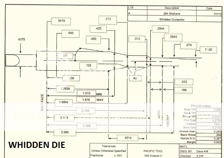

My question I wanted to ask you was whether or not this chamber cut with this print/reamer would work with a whidden die that was cut with the last image? From what I can tell, there are a few differences in the neck area. i also would own the reamer so i could get my gunsmith to cut me a FL resizing die but I could save a few hundred if i go with whidden (assuming it works).
From the looks of it, I will have about 0.004-0.006 neck clearance. is 0.006 neck clearance too much (0.003 on each side) and how much is too much clearance? I will be ordering bushing dies. In measuring a couple pieces of brass, I am getting around 0.0145-0.015 thickness (used calipers, so not entirely accurate. This means a .310 bushing if I want 0.002 neck tension.

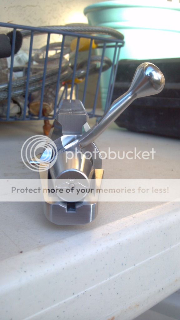

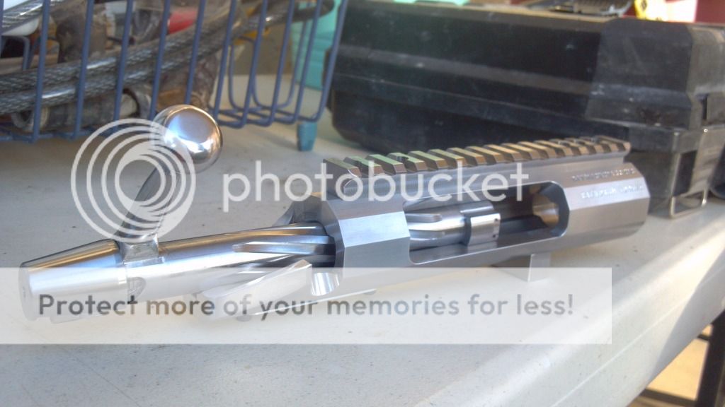

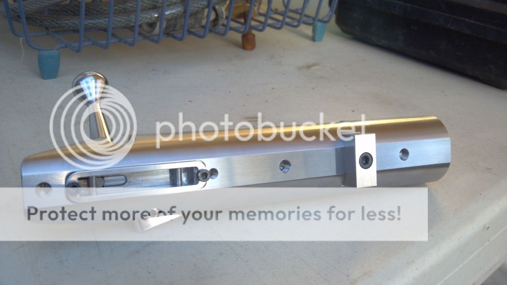

If you are interested, here are pics of the BAT action. I havent seen too many pics of one online so maybe some of you are interested in seeing pics of one at different angles:

To head off one issue, a FL sizing die simply can not be cut using your clambering reamer. The FL die reamer must be smaller than the chamber reamer.
I have a Whidden FL sizer for my Shehane. Works great. One of the better dies that I own. I had a very good experience working with them.

A chamber reamer can not make a F/L sizing die. The die reamer has to be smaller than the chamber reamer so it can size brass down. Just buy a F/L bushing die from Whidden and you'll be fine.

I am not a riflesmith but I would advise you to check with John Whidden as to the dimensions of his sizing die. The reamer die drawing you posted has the same sizes as the reamer you are ordering from PTG. As Erik wrote - " A chamber reamer cannot make a F/L sizing die. The die reamer has to be smaller than the chamber reamer so it can size brass down."

Thanks for the update. I think what Whidden meant by the print they said they used for their FL die is that their die is meant for a chamber that was reamed with the following print.

Nevertheless, the only thing now that I am concerned about is the .188 freebore for 180gr Hybrids (I probably will stick with hybrids and not VLDs) and whether or not this is going to be an issue with my necked up lapua brass with possible donuts.

I use the same lead (0.200" + the 0.014" from the 45 degree in the transition from the neck in the chamber to the lead) (freebore?) in both my Shehane and 7/270 WSM chambers. There is only 0.012" difference between my chambers and your PTG print. I would prefer a bit more lead than 0.188, but it may work depending on your jump or jam. You MAY have to use a throater with your reamer. I use all 180 Hybrids.
My Shehane has a 0.314" neck and the WSM is a 0.318 neck. I wind up with 0.004 total clearance in the Shehane and 0.005 in the WSM after turning the necks. I am not sure how far I am off the lands, but the body boattail junction on the bullet is ahead of the donut area. None the less, I use a K&M donut cutter as I turn the necks.
