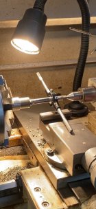

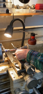

I’m just learning but we used a tap handle to hold the reamer by hand , braced against the carriage and pushed with a dead center on the tailstock.
Seemed ok and did a good job but moving forward it looks like there are many options.

Doing that way J, the tailstock needs to be in perfect alinement with the spindle. If a little high, like many tailstocks are, can oversize the chamber. The idea of the pusher is, self alinement because the 'tail end' of the reamer is not fixed, like with a center.
Understood and noted’ thanks for the tip, I’m trying to learn as much as I can in a short time.

And your tailstock needs to be in the same place on the ways and locked down to the same torque. It can be done but the pusher (as simple or as complicated as you want to make it) makes the issue moot.
YMMV
I know the tailstock is a few thou off on the lathe I use so I run a floating reamer holder.
I keep my fingers across the junction on the reamer holder as I plunge in and can feel if anything is askew.
With the live pilot in the bore and reamer butted to the dead center one could certainly feel if the alignment is askew by holding the tap holder lightly as the barrel turns.
