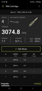

Finally got to the range, best groups showed up at 33 grains @ 2985 fps so no real increase in fps however my groups were much more consistent if that makes sense, tight little clover leafs, I felt much better about them than my Varget groups
it would seem this powder is an excellent substitute for Varget…….
