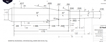

I have a back project in the works and a modified reamer I designed and
had Manson do up for me. In a nutshell, it's a modified 22 Nosler. For you
it may be just simpler to get a standard 22 Nosler reamer and go have some
fun. Here's a SAMMI print and PDF idea for you......
