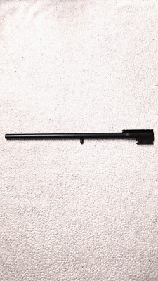

Thank you for the ebay link. I saw that earlier this evening. I believe it was $300+ if I recall correctly. I have about $200 in the used rifle. Based on what little bit I've read, Rossi doesn't recommend treating the barrels as interchangeable. Apparently the fitment to the circle is not universal. That's why I thought about just rechambering.
