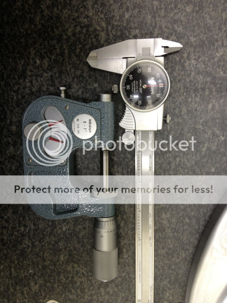

The only real advantage to this type of sorter to me would be if it sat up a little higher off the table and had a bin under each coresponding hole so you didn't have to handle them again. I could make this for you if you want to persue it. Could either buy the size reamers you want and make out of 4140 prehard or make out of A2 and harden it, then EDM the holes in it.
Personally I think measuring with the right tool would be just as fast and would give you actuals without the chance of sticking one in a hole. I use this type micrometer beside the caliper to sort parts or a snap gage. It is spring loaded and will read tenths on the indicator.
Re: Bullet Diameter Measuring Tool
That's the comparator (indicating) micrometer I was talking about, some have an adjustable platform to place whatever you are measuring on. Seems like a great tool for comparing diameters of bullets. Other methods seem to work too.That's one nice tool.
