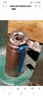

I have a primer catcher @The German made. The ram's primer gap cover that goes in the front has become loose & falls out.
I have a friend that 3d prints.
Anyone know of a file out there to print this item ?
Wrap a couple of wraps of painters tape around the whole thing to make it thicker.
It runs symmetrically with the ram. Painter tape on the outside is a no-go. I did place two very small pieces along the edges to hold it in place but one spent primer puts enough pressure on it to make it stick out so on the down stroke of the ram it jams into the press. The more this happens the more it doesn't work well.
I'm actually thinking a wooden wedge might work more better ...idk.

Check out the latest version of the slot insert - initially, I made them solid, now they have an opening in the middle that gives the whole thing a little bit of a spring tension when inserted.
My rcbs doesn't work that way. Primers go out the back slot. Front slot is for the priming arm that's not in use.
Cool, i have the T shaped one.
This is a very needed but unable to obtain part. Kind under rated imo.Screenshot_20220717-122529_Samsung Internet.jpg
