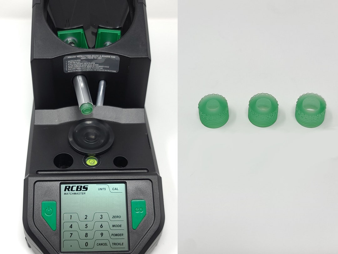

I have one been playing with the user settings to get it fine tuned. There’s a really fine line between speed and accuracy. I’ve been making special tubes to fit inside the small tube to keep the powder from dropping too many kernels at a time.

Yes, I’ve had one for about 6 months now and it’s been much better than a few other brands I’ve used over the years. I bought the inserts from Etsy (link below) and I’ve had very few over charges after installing the inserts. I’ve programmed 3 powders N133, H4198, and Varget with the custom settings in match mode and it drops 29.9 of N133 in a little under 20 seconds, 34.2 of H4198 in a little under 25 seconds, and 44 of Varget in less than 30 seconds. I rarely get over/under charges but when I do it’s a kernel. I’ve cross referenced it with other scales and haven’t seen any evidence of drift. I do all of my throwing with it placed on an anti static mat. I definitely love mine because of the precision, speed, and functionality. Certainly the best I’ve used.

I bought the RCBS Matchmaster in November of 2020. I have loaded more than 1000 rounds with it and over all I'm very pleased. I was concerned with the scale drifting as with other electronic scales I've used. This is not the case, its very stable as long as you follow the instructions and let it warm up for 15 min. I've validated this numerous time by checking with calibration weights that are close to the powder weight I'm throwing. The scale is very accurate when set to Match and can detect one kernel of Varget, H4350 or similar powder. The powder drop works pretty well but will overthrow a few kernels about 20% of the time. I just pick them out with tweezers. I can set the drop to a slower level to minimize this but, to me, its not worth the trade off in speed. I'm going to try the to nozzles Bryan Z posted.
