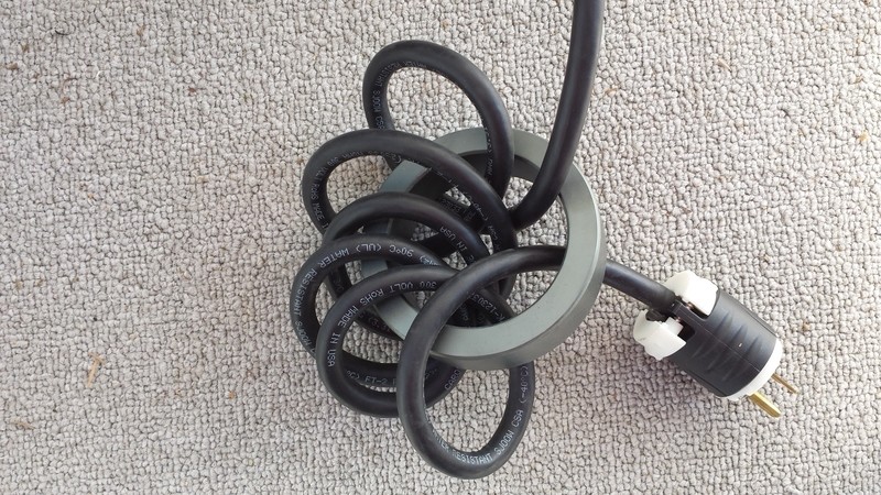

When I researched them some years back it seemed good practice to make some mods to them and one was placing toroid rings on the lead with a few wraps which absorbs any crap on the power lead that might influence readings.
