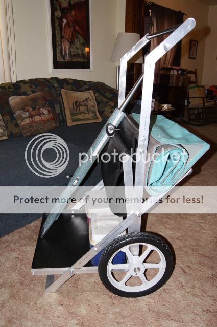

Range cart users, I need your opinions. (Pics added, FINALLY!!!)

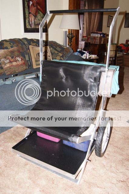

Here is the NEAR finished prototype. I was sewing the trampoline material and the sewing machine broke. (plastic gears.....) SO.... I pinned the material in place and took pics. As you can see the seat folds up and out of the way for transporting equipment. It's made from 6061 aircraft aluminum with tig welds. The wheels are 14" solid rubber (no flat tires) The frame has plenty of areas where a golf umbrella can be attached with ease. (which I plan to do.) The bottom tray is rubber coated and measures 18x24 and will hold 200lbs easily. Large and strong enough for coolers (I use two coolers. One for ammo, one for drinks and snacks.) Plenty of room for F/TR and any benchrest rests and heavy bags. I'm going to install a bungee net and Velcro straps just to keep things from bouncing around. For highpower, not shown because I haven't finished the clamp yet, will be an arm that secures the spotting scope stand on the front corner of the tray. By placing it there the shooter can use the stand while still attached to the cart for the standing position. When recording the score of the next competitor simply lower the stand and sit down. No removing the stand until the 300yd line. When sitting the rifle can be secured to the cushioned bar that the shooting mat is sitting on in the pics. Some may find it easier to transport their shooting mat and jacket on the seat when moving. If anyone is intersted in having me make one for them please contact me.
Seat up with equipment on. Please note the arm extension with the shooting mat is an option for that.
With seat down.

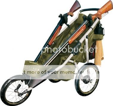

Would this work for you? Maybe could be adapted to better carry a big front rest.

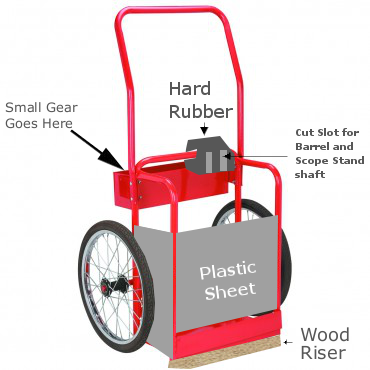

Look at this illustration:
Rod, sorry, my own cart was built from wood and folds flat. But with this, get some hard foam rubber, cut {} slots for barrel and umbrella keepers and mount that to the cross piece with self-tapping screws. on the leading edge of the bottom piece, fit blocks of wood 2-3" high. This will make the cart lean back more. On the sides of the bottom you can tack-weld aluminum plate if you want fancy, or just cut sheet plastic from a home improvement store. Plastic panels can be attached with screw or even zip-ties around tubing. Run the plastic side panels up high enough that stuff like hats, muffs don't fall out. After transport you can transfer ammo and small stuff to the upper box. We've used one of these to hold 2 prone rifles and a target cam on tripod.
The hardest component to find may be the hard rubber blocks for the barrel keeper, but you can make that out of wood, with some carpet to protect the barrels. The nice thing about the rubber is that it can be cut to snap over the barrels so you don't need straps. Likewise, you can drill a hole transversely through the rubber, then slot it from the bottom and it will slide over the horizontal tubing with no fasteners needed. Imagine a block of fitted rubber clamping over broom handle.
Keep in mind that, if you build your own cart from scratch (instead of the harbor freight welding cart) you could easily pay $30.00 just for the wheels and axle.

I use a baby jogging cart (three wheeler) on which I have attached a set of Kolpin ATV gun carriers. They bolt onto the frame of the cart.
The wheels of the cart are inflatable (I keep a small air pump with it) and easily removable so you can collapse it. I shoot FTR so I don't have a 320 pound front rest to cart around, but if I did, I could probably come up with some mechanism to carry it just behind the front wheel, on the step.
