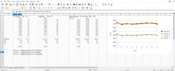

I tested a LR against a Magnetospeed and Prochrono. Here are the results. Note that the ProChonos ES and SD came closer to matching the Magnetospeeds than the LR did. I assume that is probably because the LR's mount allowed vibration of the transmitter and antenna which would affect the vector of the radar cone and cause the unit to pick the bullet up at different points.
I trust the Magnetospeed more that the optical or the radar unit to give me true readings. If I had a way to mount it on every rifle I own without it touching the barrel I would not bother with any other crono. As it is I will probably buy one of the Andiscan II's when they hit the market just for its convenience. Also I owned a LR for about a month a year or so after they came out. Too many things on it did not work as advertised at the time and their CS was absolutely the worst I ever encountered. Tried to convince me that Apple and Samsungs bluetooth technology was messed up but theirs worked perfectly LOL> Thankfully Brownells refunded me my $600 plus I paid for it
