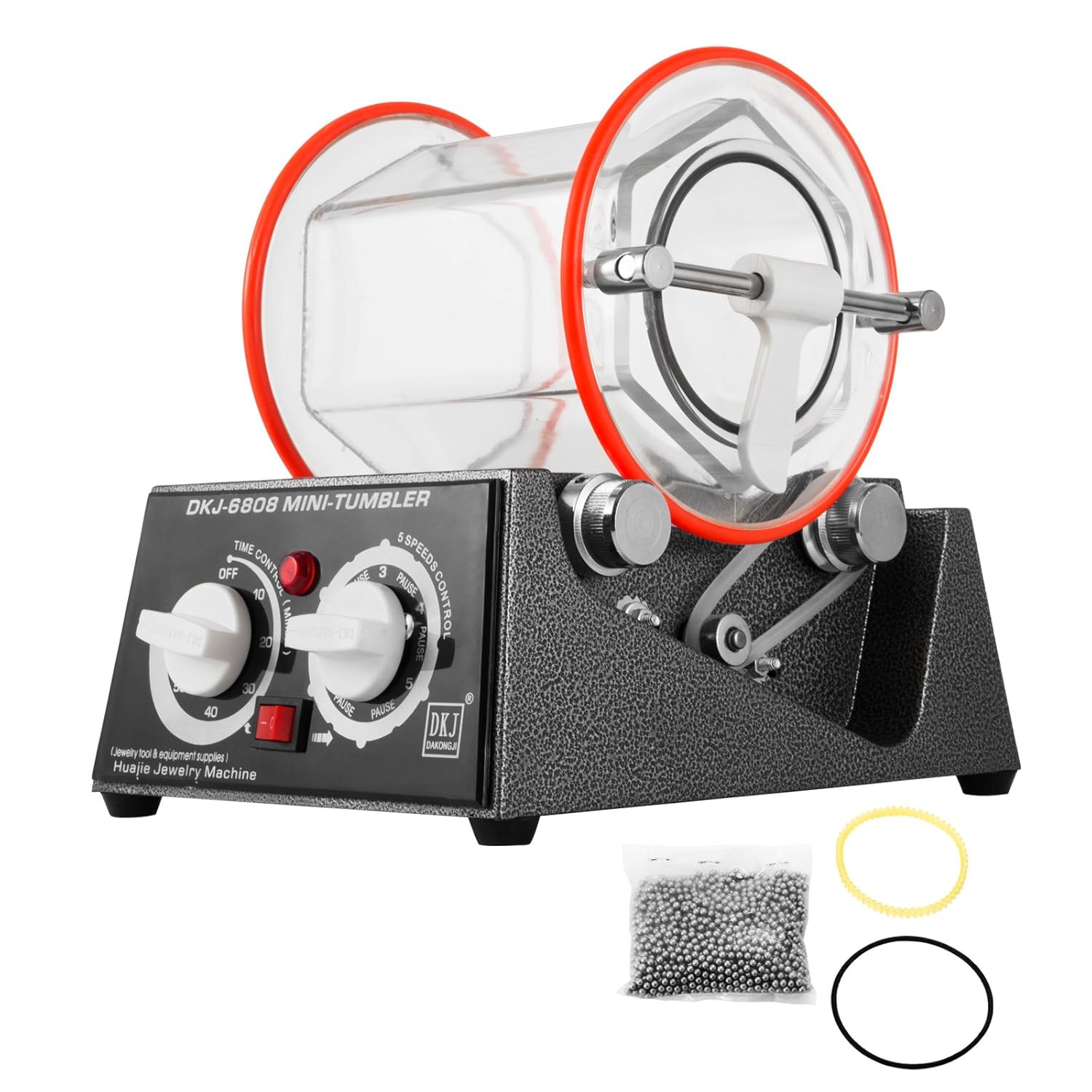

I would also like to coat some bullets so I was thinking about a tumbler. Something like this;
How noisy are these type of tumbler?

I occasionally use one of the little Harbor Freight tumblers w/SS pins. If the drums are filled properly with pins, cases and your favorite cleaning brew, the noise is very minimal...about as loud as a dishwasher. I run mine in the kitchen on top of an old phone book (dampens the cheap motor/pulley vibration) and can't hear it in my den, 35' away. If you're going to impact-coat bullets though, it might be a whole different ballgame.

The Harbor Freight rotary tumbler is stupid quiet compared to a vibrating cleaner or even the FA. But to coat bullets, you need a vibrator.
