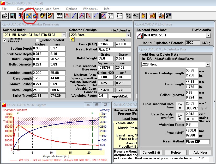

The simplest method I have for that is to pull up the Cartridge dialog from the caliper/case icon.
Change the name and dimensions that changed. Starting with a parent case with the same bore speeds things up but isn't necessary if you also adjust those values. The weighting factor is a trim on the pressure/velocity relationship. It's effect isn't huge for most improved cartridges. The weighting factor is smaller for cases with more capacity and the same bore.
Hit "Add New". It will appear at the bottom of the cartridge list in that session. Then "Cancel & Exit" to close the dialog box. The next time QL is opened, it'll be where you expect it in the list.
