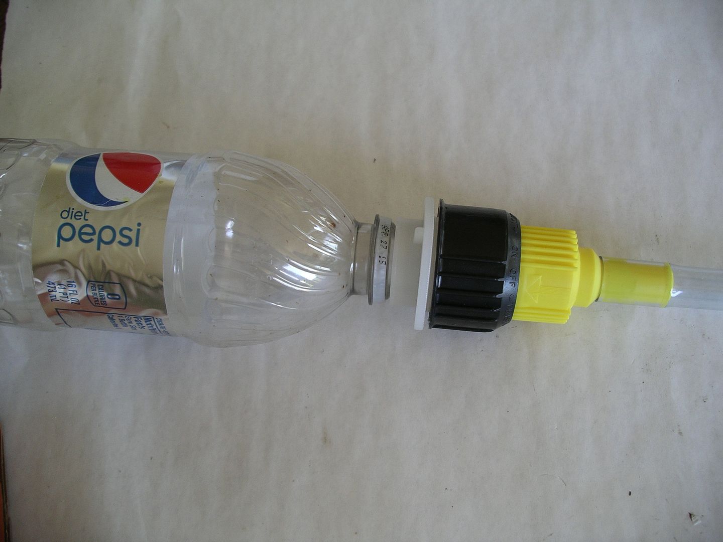

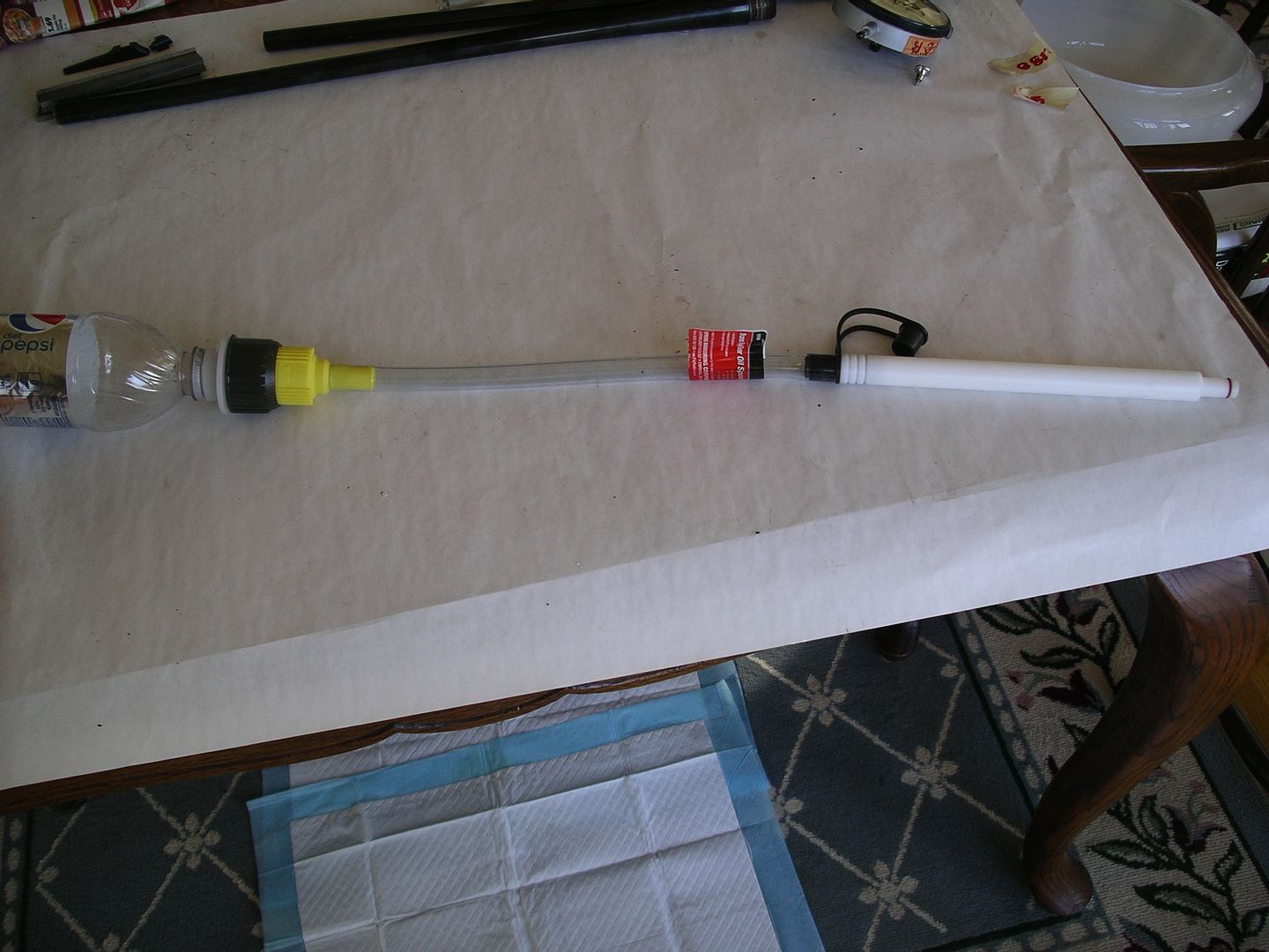

The yellow part costs around $4 at the auto parts store, fits on quarts of oil
plugs in the end of a rod guide
[/URL]
[/URL]
[/URL]
If a one liter bottle is too small, then use a two liter bottle or smaller. Takes about 6-8 oz of water.
