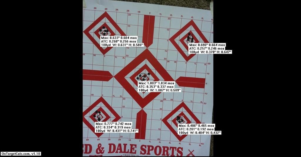

i went through a stage of building AR's.
My favorite components for a precision AR were a matched billet upper/lower from CMT Tactical, Shilen 20" Hbar, Geissele SSA-E trigger. After much work and several trys i built one that i could consistently shoot 5 five shot groups on one target and the average of all the groups would be 3/4". those who say they have an AR that will shoot 1/2" hundred yard groups all day long need to take the 5 five shot group test.
There are some tricks to assembling a precision AR. Robert Whitley has some good stuff out there on assembling an accurate AR.
i have owned one AR that was capable of 1/4" hundred yard groups. that one was built by Robert Whitley. 6mm AR turbo 40 with a 26" krieger barrel and a Geissele national match trigger.
i have since passed out of my AR stage. those hbar rifles are just too heavy to be practical, AR's are hard on your precious brass and they really are hard to get accuracy out of.
That said i still have two. my truck gun. a stock PSA. and my hog gun a 6.5 grendel with a 18" lightweight JP barrel, Geissele SSA-E, silent capture spring, built on mur upper with a CMT billet lower. 1 moa gun with factory ammo. don't even bother to reload for either of my AR's
a set of forster benchrest dies is all you need. i have had quite a few AR's. Never felt the need for small base dies. Full length resize with a .002 to .003 shoulder bump works fine.
