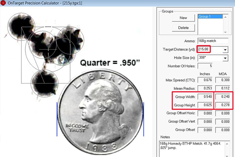

I shot this group of 5 shots with a freshly decoppered clean cold barrel with no fouling shot. The 1st shot was low and the rest were withing 1/2" at 215 yards. Funny, after I started feeling good, the groups got larger up to 1/2 MOA or a little over as I shot more and it wasn't due to barrel heat. I noticed that with this rifle, it starts shooting noticeably worse after about 250 rounds and needs the copper removed.
