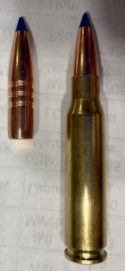

Question on bullet seating depth
The only problem I see with this load is using the wrong bullet to extrapolate data.
The bullet in the top photo is not a TSX, it’s a TTSx. the second “T” is important as for Barnes that designates a tipped bullet.
If you note the Barnes data, the TTSX requires a much shorter COL, likely because it will jam at 2.810.
Make certain of your bullet part number before loading any thing.
This is where mixing data and components can get interesting.
You are right. On the top of the box is written Tipped TSX instead of TTSX so I missed that. Should I discard the loads I've set to 2.80" C.O.A.L. (pull the bullets, dump the powder, resize the cases)? My hunch is yes.
You are right. The top of the box reads Tipped TSX instead of TTSX. My bad.IMG_2369.jpg
This is where things get tricky with load manuals and why starting low is the rule.
Barnes lists the same starting load for both bullets. The confusing part is that the TTSX has a COL about .100” shorter, so you have to be concerned about where it contacts the lands.
It go here and check out the lengths of the two bullets, you find that the TTSX is also .100” longer than the the TSX. So not only is it seated deeper by COL, you have an additional .100” due to bullet length. Roughly .200” more bullet in the case.
Somehow magically the same powder load produces the same pressure.
With your existing load, I would not pull them down. I would check to see if they do actually hit the lands. If they don’t, your well below starting data.
If they hit the lands, you can just seat them deeper and still be at starting load data.
If you’re worried or want to learn something, you could seat a few of those at different depths down to the Barnes length and watch what accuracy and velocity does with the change. Or Set them aside, load more to start your load work up and some place those will work into the test ladder.
They aren’t going to hurt anything use sitting thereuntil you have a better idea of what load works best in your rifle.
The big take away is to confirm you components.
After running many load developments with Barnes TTSX, I will add that every one of them wanted more jump than I used to start them with. They like to be seated deep.
