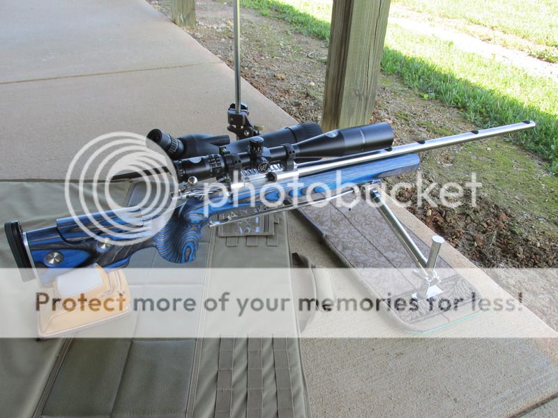

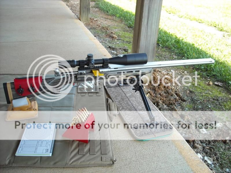

I did not like the slope of my Savage 12 stock, so I made a bag rider that was parallel with the front of the stock - see pictures below. Notice that I did not have a joystick bipod (Joypod) at the time, but a more standard bipod (Duplin). Even though my rear bag is rather hard, I had no problem doing fine elevation adjustments by squeezing it, and this allowed me to return the rifle to the same position each time, which I found easier than sliding the rifle back and forth for elevation adjustment. But then again, that is just my preference.
My new (as of last year) F-T/R rifle stock already had no slope, and I really like it; but then again, I do have a Joypod for it, which for me works out best.
Savage 12 F-T/R modified stock.
Savage 12 F-T/R with Duplin bipod.
Kelbly Panda action + Kelbly GRS X-Eater stock + Krieger barrel + Seb Joypod
Good luck with whatever you choose - your wife will definitely enjoy F-T/R.
Nando

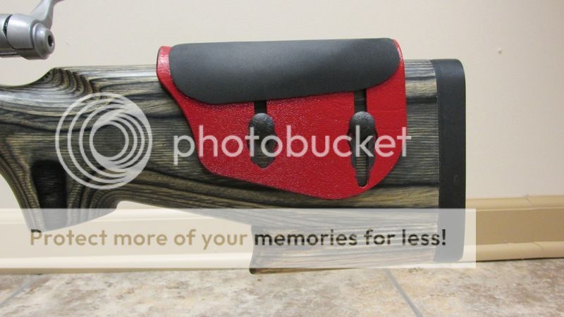

Ok, my buddy finished the bag rider, and I got it back yesterday. Turned out better than I had envisioned. Being the smart sort of guy that he is, he made it so that the rod can be reversed to either be parallel to the fore end, or have a slight taper(3º, I think). I thought that was pretty clever. He also made 2 sets of holes so the rod can be attached just below the bottom of the toe of the stock(as in the pics) or about 3/8" lower. I can't think of a reason why she would use the lower set of holes, so initially I was thinking we'd probably just have him cut the bottom off and re-contour it to match the profile of the rod. After playing around with it a little, it seems like the part protruding below the rod may actually be a good thing, as it provides a positive stop against the bag to push the rifle forward into after recoil. We'll see how she likes that part after she shoots with it again next weekend. Here are a few pics.
Flat:
Taper:
On bag:
