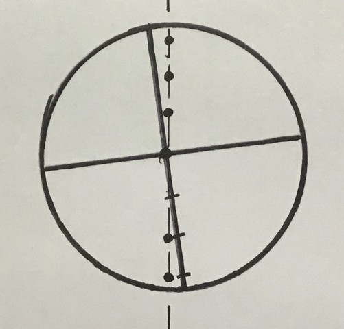

Windage drifting out at distance? And the farther the target, the more the drift? It's the Plumber's Tall Target Test to the rescue!
Two things can cause this drifting problem -- canting your rifle (if you cant to the right you will hit to the right), or having a reticle that is not pointing at the exact center of your bore. Because of the slight errors manufacturers make in aligning actions to bores, you can "level" your scope to your rifle with expensive gadgets in your living room until you are blue in the face and still have windage drift at long range. It is caused by not having your reticle in perfect alignment with your bore axis, like this:

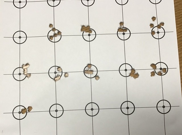

But, good news -- there is an easy, cheap, exact and foolproof fix for the mis-aligned reticle, and it involves using what for catchiness' sake I call the "plumber's tall target test." First, print off some "dot" targets on 8.5 x 11 copy paper which you will staple edge-to-edge onto a target backer, like pictured below. You want the scheme to be at least 3 pages high -- 4 pages is better. (You can buy specialty "tall targets" for this but the printed targets work just as well.)
The individual sheets should look similar to this (absent the bullet holes):
In application they will look like this:

Next, shoot and sight in while keeping your reticle exactly parallel to the dots. (Since they are plumb, your reticle will be, too.) Adjust your windage turret until your rifle is dead-on at 100 yards, windage-wise (it does not matter if it is a bit high or low -- just get the windage perfect). Once it is spot-on, shoot the very bottom dot (bullseye) in a tall row, with a couple of shots.
Next, crank your elevation turret so as to raise your POI 25 - 30 moa (or as much as you can, if you do not have 25 moa available), then aim at the same, lowest bullseye and shoot again, once or twice while keeping your reticle exactly parallel to the known-to-be-plumb dots. Because you cranked up 25 - 30 moa, you should hit about that many inchies higher than the dot you aimed at. The idea is to have the upper impact hole(s) be exactly plumb over the lower impact hole(s).
Since keeping the reticle parallel to the plumb dots eliminates the possibility of cant, if your POI is to the left or right, you know that you don't have the crosshair pointed at the bore perfectly. To fix, loosen the ring screws and rotate your scope slightly (if you are hitting to the left, rotate the scope to the right, i.e., clockwise). Then repeat all of the above steps and see if you got it right. If not, repeat the process until your upper POI is exactly plumb to your lower POI, without changing your windage turret. It can be a bit of pain to get it perfect but once done you are good forever, and at any distance.
