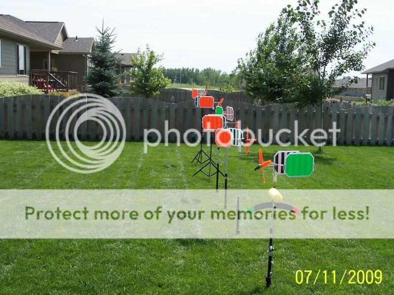

Here's mine, just for something else to ponder.

Of course it doesn't matter what color your flags are if you use them on your own property, but I think the hi Vis orange colors are the way to go. We put our homemade flags out right next to out shooting shack, and flags at the 600 mark. The ones at 600 are extra large and one solid color, and can be seen easily thru my NF scopes I use. Makes for great practice and makes everyone a better shooter.
