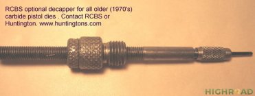

I am getting ready to reload for the 45acp. I have an older set of dies from rcbs, three dies they are not carbide. The deprimer die has the case flair all in one, I will share a picture below. the other dies one for seating bullets and then another die with nothing in it. I am not sure what this die is for. My question is will these dies work or should I just invest in the carbide dies or even a different brand? Thanks in advance.

Do you have a die with #2 on it? That decapping assembly does not have a flare. The #2 die or expander die does the flare. Looks like you're missing the flare assembly. Also the seater does not have the letters TC which indicates it has the taper crimp option. Those dies were made in 1980.

The sizing die is marked “Size #1”; the expander die is die #2 and is not marked, but the expander plug is; and the seating die is marked “Seat #3”. The dies are used in that order and are perfectly useable. While the size die is not carbide, you can lubricate the cases with a spray lube and then clean them in bulk before the next step. The next step is expanding and “belling” using the expanding decamping die. Then comes priming, charging then on to bullet seating and removing the bell with die #3. A set very similar to the one you have was my first 45 ACP die set I ever owned and I still have it.
The flare is a short bevel on the expander body about 1/4 inch above the end of the expander plug. The end of the case will need to go up this bevel until the bullets will sit inside the case mouth and not tip.
