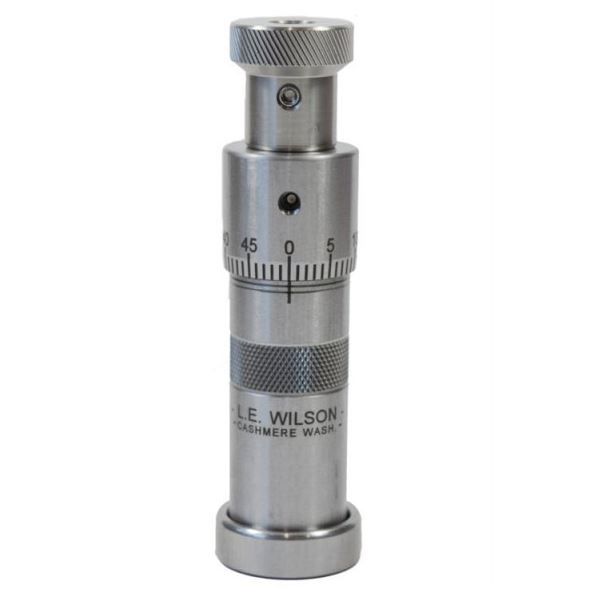

Ive only been reloading about 5 years. Was using a RCBS rockchucker for everything, and it did what I needed it too. I upgraded to the LE Wilson inline seater dies and a K&M arbor press and absolutely love them. I get a better feel when seating, and I plan on reloading at the range this summer.

I've been looking at both Short Action Customs and L.E. Wilson bullet seating dies, and the K&M Arbor Press. Mainly because these are what I'm generally finding the most widely available. The L.E. Wilson dies seem pretty straight forward in what you're getting. The SAC dies leave a lot to be desired as far as product descriptions go.

Both are good, SAC has videos on their inline seating die, Press seating die and their sizing dies, explaining it very well. The videos are on their website.

I thought about trying to load from the top on the Wilson seater die, but haven’t yet.
I wonder if putting a slight bevel on the hole ,on the top of the die, would help funnel the seater stem.
Making it easier,and fast to start the seater stem.

For what it's worth... while I do enjoy using my inline Wilson seaters and value the extra 'feel' I get when seating bullets using them... The ammo I load using a 7/8-14 threaded seater like a Redding Comp, Whidden or Forster Ultra BR in a Co-Ax - or a 550 - shoots very, very well. I can't measure the difference between the loaded rounds in any meaningful way, so there's that.
