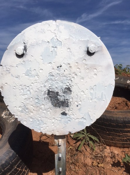

I had a custom 22-250 built for longer range ground hogs, my factory Savage was a 12 twist, but 55gr get beat around a lot by the wind so my gun builder SO Custom Rifles built me a 7.5 twist to shoot heavier weight bullets & let me just say it's a hammer. I just had shoulder surgery and right before the surgery I went out and shot a seating depth ladder but I have not had a chance to chronograph it yet so I'm not sure what speed I'm getting.

I challenge anyone to do this with a 12 or 14 twist 22-250 barrel. That’s 5 shots in about 2.5” at 710 yards with 75gr Amaxes. The same load routinely groups in the .3s to .4s at 100 yards.
John

I'm not real sure exactly what point the cat is trying to make...he doesn't really say what his twist is, but because he is issuing a challenge to slower twist rifles I am guessing his is faster {as it should be to shoot like that}....if it is, then exactly what you said is correct, he matched the twist with the bullet and that is precisely what we are advocating, so why the challenge???
My barrel is an 8” twist Criterion.
The point I’m making is I fail to see the downside to the faster twist. My fast twist 22-250 shoots as well as a slower twist and has the advantage of stabilizing high BC bullets that fight the wind much better than the faster but lower BC bullets. I have not tried the lighter bullets in my barrel yet, but I suppose I should just in the name I’d science. Every one I have talked to though says they work just fine with no degradation in accuracy.
I’d bet that if manufacturers quietly shifted over to an 8” twist, Joe Consumer would never know the difference and those rifle loonies like me would be elated with the ability to shoot wind bucking high BC bullets.
