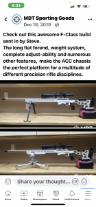

Trying to find what was used in this MTD classic chassis forearm for F class it appears to be a nylon plate, but I’m not sure whether it was custom

I've made and used acouple if those on a couple of rifles I have. If I remember correctly
I think the material was called Delrin.
I just measured the longest one I have on a 260AI. It's 15 inches long. I did that on purpose
so I could adjust the fulcrum point on the rifle in the front bag. I could always shorten it
later easily once when I found the sweet spot.
Reactions: RKS
It could be just a aluminum plate that's powder coated but, Delrin
would be preferable. If it were me, and the thickness shown on the
plate, I'd move it forward a good several inches.
