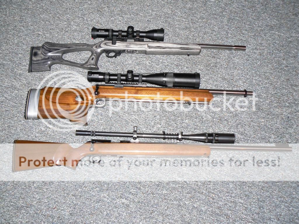

I've only got 65 rounds on my barrel. Had to work out the kinks a little with the headspacing and washers provided. The scope in the picture on the rifle isn't on it right now. That was just a 2.5-10x scope. Right now I've got a 6-24x scope on it. I shot the gun right before last night. After firing 10 rounds thru it I had no misfires. I was getting one or two misfires out of every 20 rounds. So I took one of the headspace washers off and no misfires. The next 10 rounds I fired I fired for groups. The two five shot groups I fired came in at a .208" and a .238". The ammo was just CCI standard velocity.
I did bed the stock/action assy. I feel for not doing any adjustments to the trigger and I'm using it as it came and I'm pretty happy with it for now.
The gun shoots straight, the scope when I make adjustments puts the bullet right where it's suppose to go. So for 65 rounds thru it for now. I have no complaints at all.
