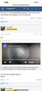

I recorded a video via my Teslong if it helps with the carbon ring question (apologies for my kids screaming in the background)

It looks to me that your methods are good. All we’re trying to do is help sometimes people skim through without fully reading so I know it’s frustrating. Those are not land marks on your bullet. I can’t tell by the pictures although there very good pictures but it almost looks like there not trimmed or chamfers well enough and that’s probably just glare but worth looking at. Also in your video there’s a definite start of a carbon ring on the start of your lead. Don’t know if it’s enough to scrape your bullet or not. I’m convinced with your method of brass prep it’s not s shoulder bump problem and if it was at the .200 line you would have clickers and you haven’t mentioned that. Give her a good scrubbing with some jb bore paste or something similar and your normal cleaning methods and re scope it. I think this is fixable without much work.

Somewhere around 13 seconds into your video in this picture of your video on the right side there’s a dark ring just past the neck, where the neck ends and your lead starts that’s the start of a carbon ring . It’s very narrow but very distinct
