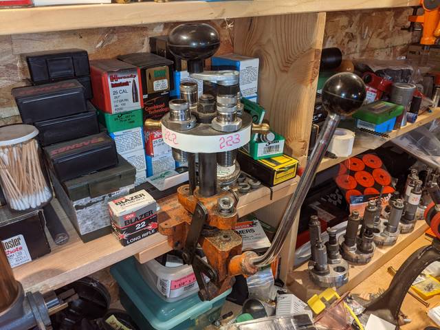

I have Wilson and C&H trimmers they are clones of each other, I just don't which came first but the C&H is far less expensive. I have Lyman and Redding trimmers set up for some odd metric cases and yes they aren't very consistent but close enough. Surprisingly I really like the Lee Quick Trim system and have four dies set up in an old turret press it is much like a vertical Wilson and you don't have to adjust.
