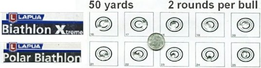

I have a Ravage Ridgeback due this month also should have been mid September but they said they're running a bit behind was really hoping to use it in this month's match.
Have a couple lots of Midas, Center x and Tenex to try hope it likes one of them
I've been trying those same ammos, plus Polar Biathlon and Biathlon Xtreme. The gun really likes those last two.Lapua_Biathlon-Xtreme_+_Polar-Biathlon.jpg
