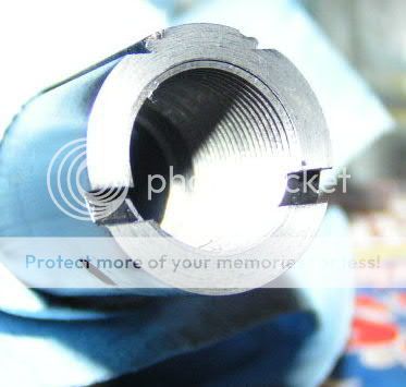

Here's some pics of the rifles I have built to shoot in BR events this year.
