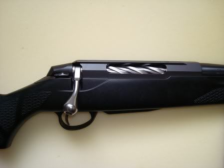

Hey Guys,
Here's a pic to my Tikka T3 in .223 and a little mod. that I did. She's a tack driver. Paul.
www.boltfluting.com
I like it 8). I emailed Kampfeld Custom about doing Tikka bolts. They said it was a go ahead,so I'm looking forward to getting one done up spiraled and one straight. Looks great to me and ounces are ounces. The more I can shave off the better.
