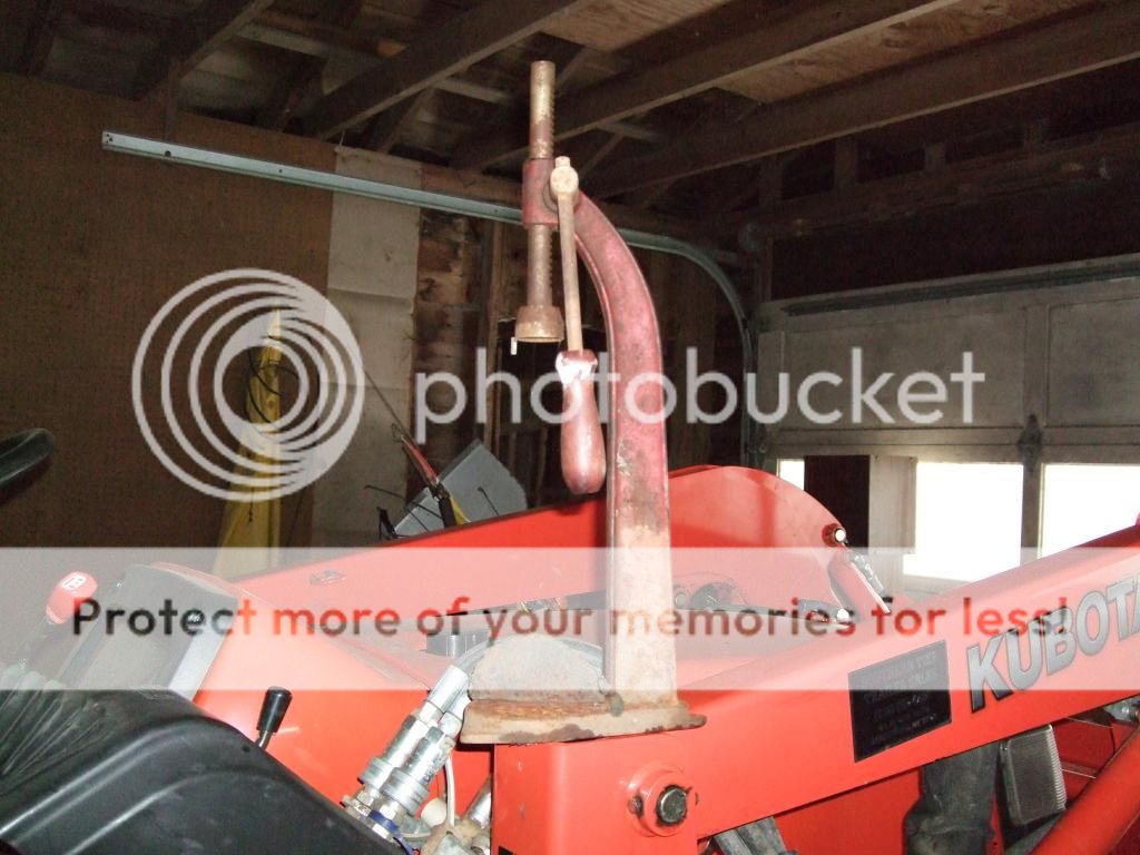

I had a old bottle capper in the garage and Mike spotted it and uses it for seating bullets with one of my inline seaters..
I'll see if I can snatch a photo of it...

Here's that old bottle capper that Mike snuck off with..
A little paint work, and a block of wood the correct size and he'll be good to go...
