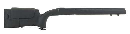

This is the stock I use and the rear bag,in the picture I use the bag #42.let me know what you think.I was thinking that the #40 would be somthing that would work better.

Here are pics of my various bags and a coffin butt stock. The first pic has the same bag you have. The fit is no good. The other 2 bags have 2 rows of stitching between the ears and the fit is very good. I use the 2nd bag with my round profile stocks and knead the ears to allow the toe to sit down onto the main bag like the rifle in the pic. I still need to check it before each shot to make sure it hasn't ridden up on the ears. It's easy to forget this with possible thrown shots as a result.
NOTE !!! I do not shoot the rifle with it slid forward on the bag as shown in the pics. These are just to show the fit of the stock.
Everytime you fire the rifle the sand in the ears gets displaced. Then when you slide the rifle forward and work the bolt, etc the sand moves around some more. Then on the next shot it displaces again. The problem is that it is not consistent shot to shot. If you can remember to press down on the comb of the stock before each shot it may help your groups.
Rounded corner stock. You need the taller ears and more spacing.
The stock pressing down is right. I tap my down and then push it down. If you don't do this you'll constantly be adjusting your elevation.
RHINOUT!
Looks like the sling swivel studs are still in the stock. Remove those for bag shooting or set the rifle up as to have the rear stud out of the bag to the rear. Also, with a heavier recoiling rifle like the .308, the bottom of the grip can/will hit the rear bag under recoil if the rear bag is too close to the grip. My .308 is in a McMillan A2 Tactical Stock and the rear stud will not come out. The bottom of the grip hits the bag every time under recoil if I shoot from the bench. I just have to adjust the bag and drive the rifle more so than I do the 6BR.
