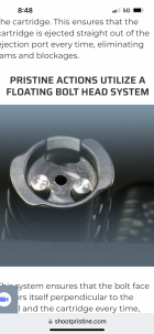

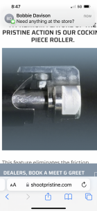

For a company with a new action their marketing pictures aren’t too impressive. Looks like a lot of drag on the firing pin. And they sure didn’t post pristine pics.

All of that “new” innovation and probably still making the action body out of 416R stainless.
Is that correct?
also, are we just assuming the 6 small lugs are stronger than two large ones?
I just dont see the value of $1300 in that action. Floating bolt head with 6 lugs? No integral recoil lug. Bolt lugs same diameter as bolt body, all this copy about ease of machining and charging a premium price.
