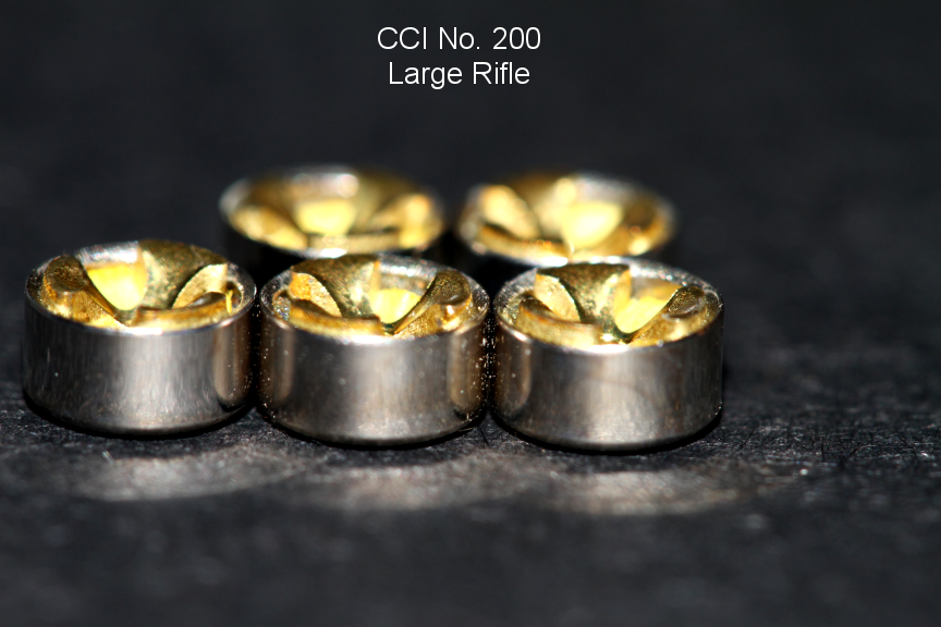

My reasoning for seating a primer till it bottoms out is pretty simple in that if we look at brand new out of the box factory manufactured primers we can see how the anvil extends just above the rim of the primer cup. Under magnification I see this on all new primers.

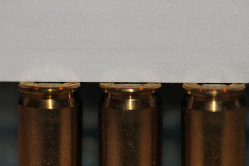

Notice the anvil does extend beyond the top rim of the cup. Primer cups on cartridges have depth and width specifications and primers have height and width specifications. Depending on the actual numbers my primers when seated till they bottom out generally end up about 0.003" below the case head. Pictured below using a white business card as a straight edge.

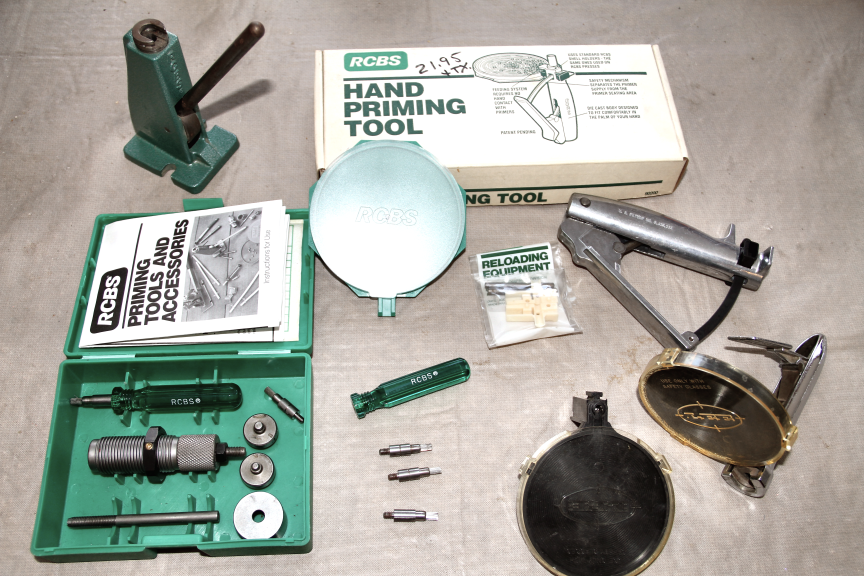

I've been playing with one the last two or so months with two mods. One, made it a bit more used friendly by replacing it's 59 Cadillac coil spring with a lighter one and two, made a .020" shim to slip in between the handle and body to limit it's ram down stroke so it can be used it to seat primers one at a time without the primers taking flight out the tray slot. If for some reason I want to or need to use the tray I'll simply remove the shim.
On the downside it may be a little on the bulky side for those with smaller meat hooks, but overall its not a bad piece considering the price.

I spent the money a got a good hand held Sinclaire primer seater. My primers are set by feel; every cartridge is different and every piece of brass varies by learning what a primer feels like when it is sufficiently seated is a learning process. I don't have misfires or seating problems. There's a simple learning curve where you develop a feel where you know you have a proper depth.
