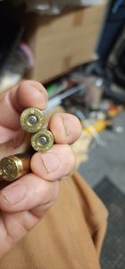

Why is it wrong? In his two tests he found .009" crush to be the best with his combination which aligns closely to SAAMI maximum depth which is .008" (which would have resulted in ~.008" crush with his pockets and primers). He was using primer pockets and primers within SAAMI specs which suggests SAAMI was on to something in their recommendation. I previously posted a screenshot of his drawing with his dimensions he was working with and I'll post it again here.
That is only the case because in his example the primer pocket is the same depth as the total thickness of the primer (cup and anvil).
The current brass I'm working with has pocket depth of .124 and the 450 primers I have are .117 total and .112 cup only. That means I need to seat my primers .007 below flush just to get the feet to touch the bottom of the pocket and .008 below would result in only a .001 crush with a maximum crush of .005 when the cup bottomed out in the pocket. In addition the bottom of the primer pocket is narrower than the opening by .004 meaning I really have to push them hard to even a little crush so hard that it is deforming the exposed bottom of the cup. There is a little circular protrusion. See picture.
Based on the picture from the SAAMI book earlier in the thread, the thickest allowable primer doesn't fit in the shallowness allowable pocket without a .009 crush and at that rate it is only flush. Even the deepest allowable pocket requires a .003 crush to be flush.
I know that's a lot for an old thread but I just got this CPS seater and I'm trying to figure things out.
Thanks for putting up with me.

I agree it's too much but
1) apparently that's how Federal says to seat them per an earlier entry in the thread which is what prompted my comment and
2) that's exactly what he is showing in his drawing on the right side, the 450 primers, the cup is bottomed out in the pocket.
