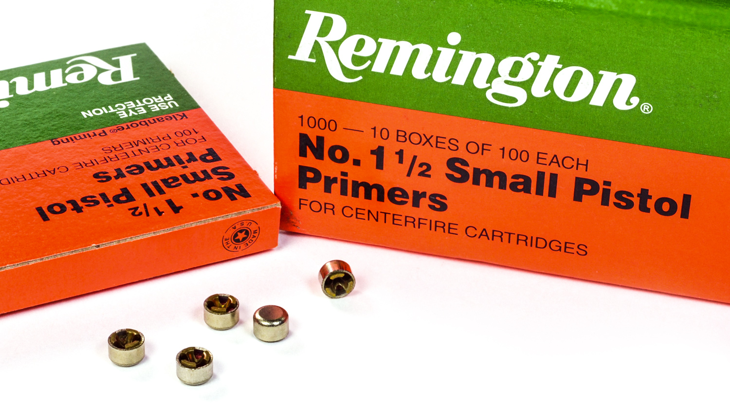

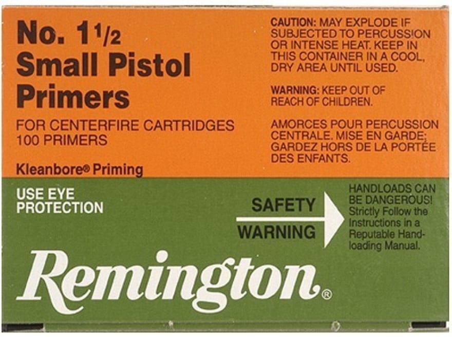

Also be especially careful with Remington 1 and 1/2 small pistol primers and Remington 6 and 1/2 small rifle primers.
Here's the warning printed on the packages of Remington 1 and 1/2 SPP I own. First a photo I took that isn't great but definitely shows Remington says this is a Safety Warning.
Then a copy & Paste from MidwayUSA
Special Note:
  • These primers are NOT recommended for loading high pressure loads such as 357 Mag, 357 Sig or 40 S&W. Please consult a Reputable Loading Manual for loading data.
And a magazine article
